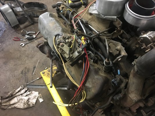

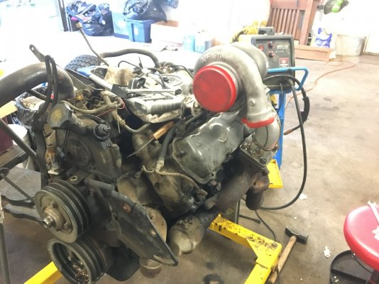

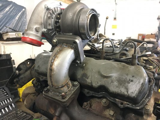

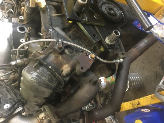

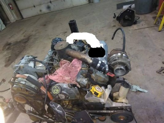

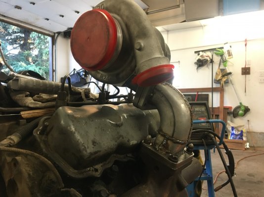

A bit of an update. I’m almost able to start the assembly on the engine. All of the machine work and balancing is complete with the crank polish being the last thing. The machinist said the the balancing was abhorrent. A 600 dollar job as apposed too 300-400 on a regular gas V8. The only thing is that the piston rings and valves are proving hard to come by so we wait. In other news, as a result of an engine swap I did for someone, I have a seized NA 7.3 on a stand to use as a template for mounting and reference while I fabricate components. So far I’ve been able to fab up my elbow to move my turbo mount up and over to clear certain components in the truck.

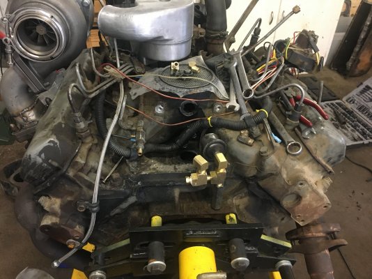

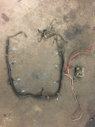

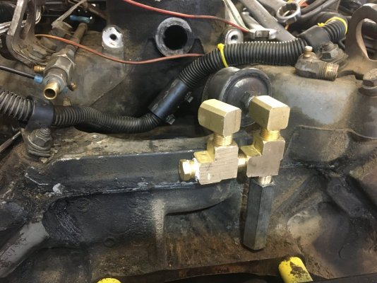

I took the existing wiring harness of the ‘89 7.3, stripped out the glow plug wires and replaced them with new wires and routed everything to the new controller location on the dipstick support bracket. I think I will disable the controller function and go manual using the ribbon for the 6v glow plugs. I left all of the wiring from the 7.3 harness for fuel pressure, heater, water in fuel, etc as the loom is to nice to tear apart and it has everything I need in it already. So we’ll we for future use I may be able to use some of those wires for custom connections. You can see also my tree of brass fittings for my pressure sensor locations. I’m doing it this way so as to make room for the turbo down pipe that will get put down past that area. I’m also doing away with the CDR valve and instead I will run three separate vents from each valve cover and the valley pan in to a breather/catch can assembly. This should eliminate almost all crankcase pressure and chances for oil consumption. I’ve found that while running a straight road draft tube from the CDR location that my daily 6.9 would burn almost a quart in 400km’s time Until it started leaking from the valve cover gasket and then it wouldn’t burn near as much. It leaks less oil now than it burned then. Figure that!
I can see why the back of the valley is popular for turbo positions as there is a good amount of room when it’s all cleaned up.

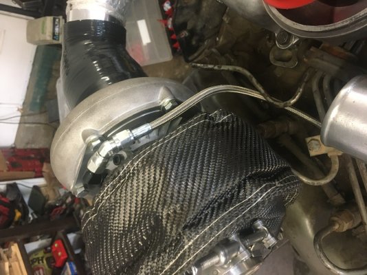

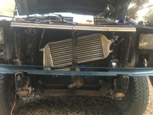

I decided to do it differently and run the oil feed line off the crankshaft oil gallery. It seems to be an out of the way place to route it.
The inter cooler is something meant for a Mitsubishi Eclipse I think. We’ll see how it does as far as hurting the efficiency of my radiator with all of the blockage in front. I tilted it to give the best approach for the piping entering and exiting on the driver’s side.

looks like your working off a Rajay kit. How's the down pipe going to work?
SO THE WAY I HAVE THE TURBO REPOSTIONED IT WILL BE EASIER TO CLEAR EVERYTHING AND SEND IT DOWN THE STOCK LOCTION BETWEEN THE BELL HOUSING AND FIREWALL.

What if I were to weld a sort of spine on the back of the elbow like 1/4" rod or something like 1/2 flat stock bent on the edge?
Sorry I never got back to about this but I would most definitely a spine to the back and maybe some 1/2'' wide flat stock to the sides angled between the flanges. That exhaust pipe will definitely crack holing the turbo up with the heat and vibrations
