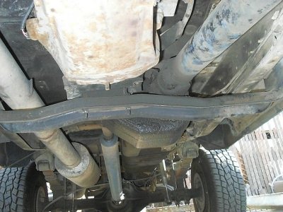

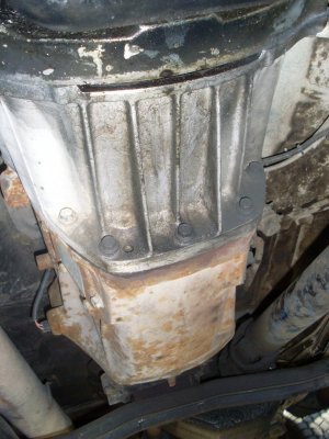

felt well enough to supervise my latest project. Replacing a ZF where a T19 used to be and adding a GV. previously, the D50 was removed and a D60 changeover installed. here are the pics. The big stuff is installed, but there is still much work to be done. Drive lines angles still need to be pitched, GV wiring needs to be installed and the transfer case shifter needs to be installed to. post any questions here!

Where'd ya find the parts? Id love to find a 60 & zf5 to swap. Or even mod a zf6 in haha
1,437
I buy and dismantle more trucks than you can imagine. the transfer case,GV unit, and driveline was bought in a wrecked truck back in 2006. the D60 and ZF5 came in another truck with a seized motor about two years ago.

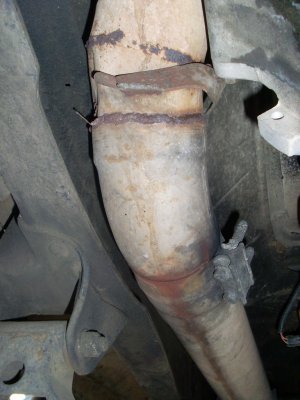

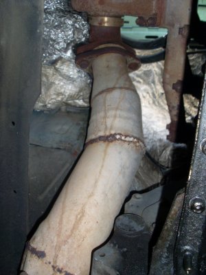

1,766
Clare, Mi
And what's with the exhaust? Looks like a stock Y pipe, and a down pipe for a turbo.
1,437
the "thing" hanging down is a vibration dampener doohicky. i figure the cheapasses at Ford's accounting dept allowed that item to be installed, it can't be all bad. I have a tendency to attempt lightspeed when driving, so any driveline vibration is not wanted/desired, therefore I minus well leave it on in the meantime.
I pulled the turbo in order to make the trans swap a little easier. it's going back in once the bugs under the truck are ironed out
