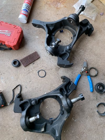

Made some progress today, got the knuckles and spindles loose. U joints look solid, nice USA made non greaseables, so gonna leave em in.
Watched a video in Dana 50 rebuilds and they just gave the knuckles a few whacks and it dropped out, beat mine for idk 30 mins and didn’t budge, pulled out the new pickle fork I bought for this job and 5 hits later it was on the ground lol
Lesson learned, just because someone puts it on the internet, doesn’t mean they know what they are doing lol :)
Ordered some new dust shields, gonna just bring the knuckles to a shop and have the ball joints pressed out and new in, save me time. Thinking about painting them as well, nothing crazy just a little rattle can job.
Then I’ll tackle the pivot bushings, installing the new races in the hub, and start to button it all back up.

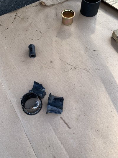

I went from being a Hack, to spray painting parts black lol
Made a lot of progress, new Ball joints are in, 1 of 2 pivot bushings are in, hopefully get some more wrapped up tomorrow.
