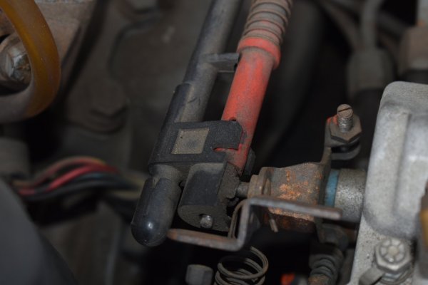

Google to the rescue. This is it.
This one is not clipped on, just next to the cable.

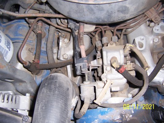

Mine isn't clipped either. It's not attached to the mounting bracket in this picture because I usually leave it laying beside the throttle cable, unhooked. The cruise doesn't work anyway.

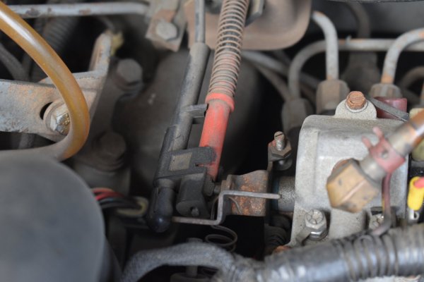

This got me curious. I've never liked cruise control on any vehicle, and never used it on my truck. Maybe I'm a control freak, don't like giving up that bit of control. That being said, mine is there, clipped on where it should be. Picture to follow.
