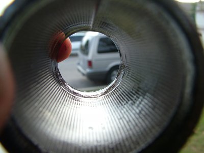

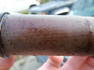

Perhaps I was just a bit hasty thinking that the screen was clean enough to reuse. I took a closer look this morning, and got some pictures.
True, much of the crud has drained off, both the outside and the inside surfaces. But the screen itself is still pretty well plugged. Pictures below, 4 days after use and plugging.
The dimensions for the screen/filter are: length=3 11/16, ID=1 1/2, OD=1 3/4.

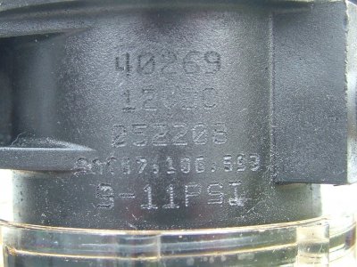

I just took another look at the Carrier pump, and it suddenly occurred to me that the numbers on stamped on the side might have meaning.cookoo I'm adding another picture. The top number, 40269, looks so very similar to the facet part number. This might be significant.

I wonder if putting the screen in boiling water will clean it...:dunno Usually if something like this plugs up just force fliud or air pressure thru it from the opposite side that it plugged up from. That usually cleans things out...:dunno

No. The top end is a push fit against the pump motor, and the bottom end is the same against the bottom of the sediment bowl. The only passage for fuel is through the mesh of the screen.
So far as I know nobody has come up with a definite replacement. We've found some that look good, seem about right. But nobody has said, "Yes, that's the one."
I'm still working on the idea of cleaning the one currently on the pump.

A bit of progress. Yesterday I spoke with a very pleasant young lady at Utility Trailer Sales, in Lathrop, CA. She couldn't have been more helpful.
She looked through a number of books, since I couldn't give her the pump model number (it's not readable), and finally said, "I think this is it. The part number for that screen filter is 30-01108-20. It's in Book #62-10876. It's an 80 micron filter. That's the good news. The bad news is that it's no longer produced, and the factory has no replacements."
Then today I spoke with Calvin (twice actually). On the second call he reported that someone had come up with the part number, from an independent source. He gave me the number 30-01108-02SV. Notice, the last two digits are reversed, and he added two letters. Sounds like either he or I or the woman in Lathrop transcribed those last two digits.
We're making some real progress here.;Sweet This is particularly important since I still haven't found anything that will effectively clean that filter screen.
These part numbers, btw, are, I think, Carrier numbers.
