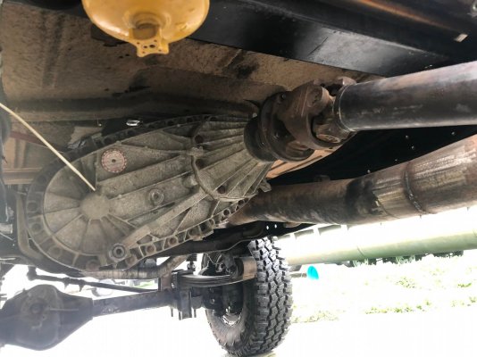

please tell us a little about the truck.
as stated, i had a hell of a time with this.
changed transmissions, clutch, transfer case and rearend to no avail.
turns out i needed a DC rear shaft (double cardan)
also known as a constant velocity (CV) u joint set up.
after i did that, the noise completely went away.
