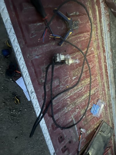

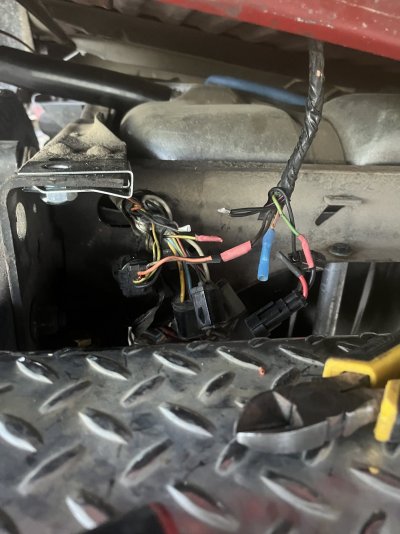

Heres a 2-1 ground split I did for some flatbed taillights. Adhesive lined 4:1 heat shrink tubing. I strip about an inch of shielding off the wire, overlap, fold over each other and then twist together. Shrink the tubing over it (preferably overlap a little more than in this picture). The wires cant unfold due to the squeeze of the tubing and the adhesive lining seals the ends of the connection from the elements. Might be beneficial depending on your area - my truck gets exposed to alot of ice and road salts frequently and those crimp connectors dont do a great job of keeping that out of the connections.
