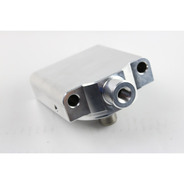

If you want to keep an OEM style filter head but without the air issues, I 1000‰ recommend this:
Never-Have-I-Ether
That's just a stock 6.9 filter head. He more than likely has that already if his truck is stock. It was only the 7.3s that had all the gadgets in the filter head.

Why do you consider a 7.3 filter head an upgrade? You can just get a water separator (a replacement filter with a drain petcock) to spin on the stock filter head. The 6.9 and the 7.3 filter heads use the same filters, so neither is an upgrade.
Napa has the filters with petcocks for either 6.9 or 7.3. the only difference between the two, is the 7.3 has sensors and heaters in the head and filter itself. 6.9 only has the water in fuel sensor on the head, and heater on the intake fuel line of the filter head.
Rock
NeverHave-I-Ether
Jan 18, 2022
304
214
Texas
Rock
Ah I was unaware of that, I figured they were the same.
