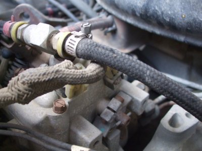

Unplug the 12V to the IP. Wont start then. Would a thief even try and pop the hood?
They might and I realize that if they really, REALLY want it, they will get it. I will just feel more comfortable knowing that I have done something to slow them down. Your idea here intrigues me...is it that simple? just pull off one or both of the electrical connectors shown in this pic?
regarding the other ideas, where is a good spot to cut into the red wire with the green stripe? Is that the FSS, and if not where would be a good place to tap into that circuit?
