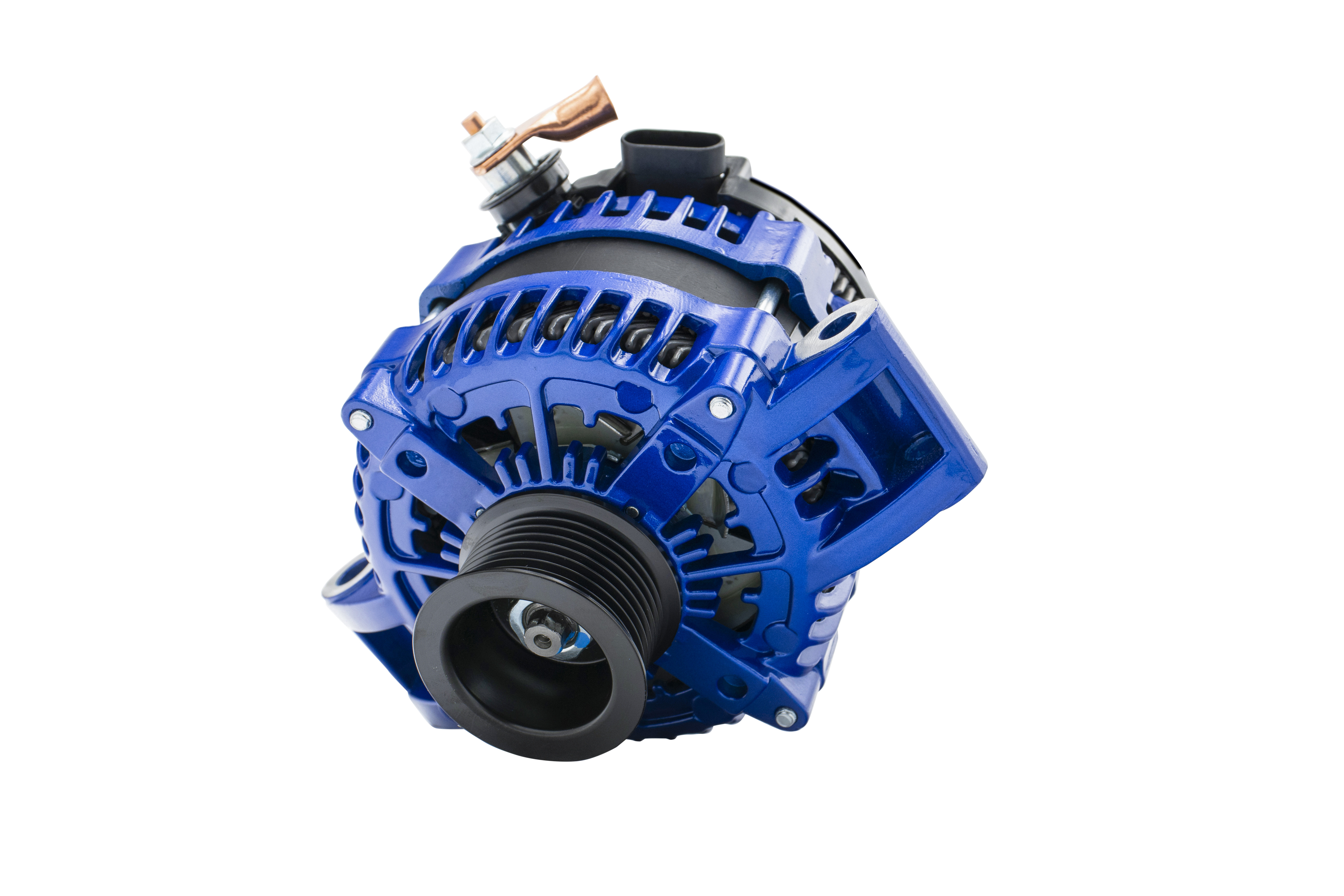

Fwiw, when I got my truck the alt was bad, I thought I’d do it once, do it right, rebuilt motorcraft, new regulator, new batteries, it lasted just about a year. When my gen 1 went out, I looked at rebuilding it myself, read a lot, watched some videos but your dealing with an alternator that was practically obsolete when our trucks got them and they’ve been rebuilt umpteen times with Chinese guts so if you don’t want to upgrade, I’d second just whatever chain with lifetime warranty is closest to you. I like to check a job off and not go back to it again for at least a few years in the end I bought this set and I’m really happy with it https://classicdieseldesigns.com/co...ducts/3g-alternator-swap-kit-for-6-9-7-3-idis

But I also like RVITKO’s suggestion. 3g is more simple to diagnose in the future with it built in regulator. Also charges at a higher rate.

It's easy to suggest a 3G upgrade, but it has a few issues that need to be resolved or lived with if you swap. Namely a single v-belt will not support the full output of the 130 amp unit, so the belt tends to squeal after start-up.

I have not had issues with a squealing belt on my alternator. It is a 130 amp 3g with a single driven v-belt and a second belt that drives the vacuum pump. I've got some high amp draw accessories on the truck, a winch and a 2000 watt inverter. If you put a 1500 watt 120VAC load on the inverter the inverter will pull around 150 amps from the batteries and the 3g will put out around 65 amps at idle and around 135 amps at 1400 rpm while that's happening (all verified with a current clamp).
I'm not saying he would be guaranteed to not have any issues on his own truck, but on my truck the single V-belt has been sufficient even at max output of the alternator.
