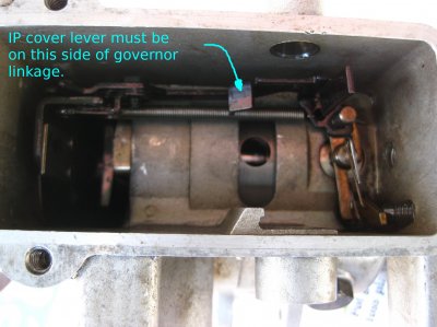

Didn't get it on right. Try again.
I faintly remember putting it on and sliding it back into place. Been a while though.

^^ What he said. Put the top of the pump on by kind of sliding on from the front of the IP to the back.
