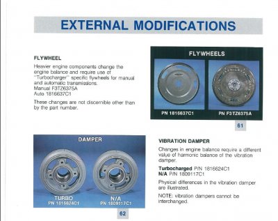

Ok So I'm swapping in a 91 7.3 IDI into my 93 Factory turbo truck. My question is can I use the IDIT flywheel on the n/a engine? It's a single mass conversion, but was purchased for the Factory turbo engine. Had I to do it again I'd of purchased the single mass flywheel kit for the n/a engine. Had I not been reading Towcat's thread regarding the different flywheels for the IDI and IDIT I'd of never thought anything about installed the n/a engine and run down the road. Assuming I had no weird vibrations.
1. Run the IDIT flywheel on the 7.3 IDI engine, do I need to use the IDIT harmonic balancer also?
2. Have the flywheel balanced to match a n/a engine, but don't I need to balance the whole rotating assembly?
3. Purchase the non-turbo single mass conversion flywheel and use it instead.
So what are my options here? Keeping in mind I'm cheap and in my crewcab I put a 6.9 flywheel on my 7.3 with no ill effects so I'm not an engine balance boyscout by any means. I'd really like to just put on the flywheel I have and run.
Thanks,
Jeremy
snapshot source;
http://www.ford-trucks.com/forums/1...om-grandfather-idi-to-new-born-baby-6-7l.html
also,for the drastic differences between the n/a and the turbo cranks,check out this thread on fte with pics showing them both.clearly you can see why you can't (shouldn't lol) interchange them.all will become clear;
http://www.ford-trucks.com/forums/1222045-idi-vs-idit-crank-shaft-2.html
Before seeing the article about the balancer I was goning to say do not switch it from the engine it came on.. Unless your doing a complete rotatiin balance shot. Then it will not matter what you have on either end of the crank.

yeah I'm back on the fence now......A correct flywheel is only 125 bucks, but I could of been Ok if I'd of been thinking when I ordered. Still seems like I should be able to have my flywheel balanced by itself to the specs of the n/a engines. Somehow the manufacturer is "balancing" them to before they ship them. I agree with Hesutton that every SM flywheel I've seen all have the same look to them. So it must just be the balancing holes that are different? I'm going to run it by my engine guy to get his take on it also.
FordF250 that is a good read right there. Thanks for the link.
Ok just did a little more poking around. The flywheel for the n/a is listed at 51 lb's and the flywheel for the IDIT is listed at 50 lbs. Not sure if it means anything or not.

Ok did some more looking Got pics of both flywheels. Definitely start with the same forging, but have different balancing done. I'm sure the IDIT could be made to fit an N/A application by balancing it to match the n/a application. How I figure that out I'm unsure. Anyway posting this for info at this point more than anything.
FW127-n/a
IDITapplication
idiabuse
Oct 15, 2005
1,242
Princeton Fl
yes and NO
yes it bolts in, No it wont match the factory balance.
Wish I had the pics to show but it will be out of balance enough to shake.
I do have a pic of the harmonic balancers and they are both different by a good amount.

On my 7.3 I used a Turbo balancer and a N/A flexplate, the heavy two piece unit, unlike the one pictured above.
Of course I had my whole recip assembly balanced.
The Engine has turbo rods/pistons the cranks are all the same 6.9/7.3.
So yes getting the balance can be a bit tricky and on a diesel you dont want ant inbalance cause that will be an expensive grenade.

No the SMF flywheels can't be swapped. I made the mistake of using a turbo flywheel on my N/A motor when I did my SMF swap. It made it shake like crazy. The turbo flywheel is balanced differently to account for the different connecting rods in the turbo motor. I was able to exchange my flywheel since at the time of ordering it was the only one listed. I didn't install it until several months later and by then the catalog had been updated to show two different flywheels.
