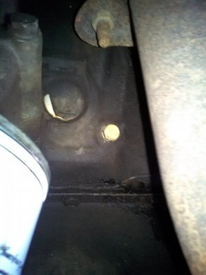

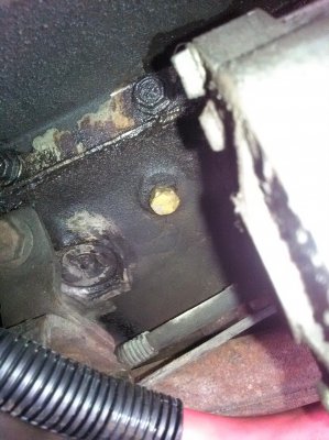

There are plugs on the block that can be pulled to drain the system totally. One on the driver side next to the oil filter and one on the passenger side next to the starter. When I did my cooling system flush I refilled with Final Charge $12.50 gallon at Walmart I know Walmart sucks but they have the best price.

I mentioned pulling the block drains in my flush post:dunno
Anyway Final Charge is great coolant! If you flushed and refilled with Final charge you shouldn't have to worry about your cooling system for a long time.;Sweet
