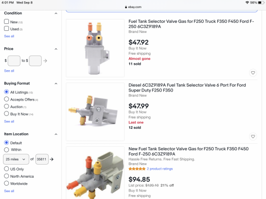

Is your truck running right on one tank and not the other? It may be the fuel selector valve or just crud from a 30 year old fuel tank. I’m getting ready to pull rear tank on mine. Driving on rear tank and saw fuel pressure going down until it stopped running. Changed tanks still low pressure. Blew 15lbs of air pressure through inlet hose to fuel pump (back to tank) fuel pressure came back and I‘m just running on front tank till I clean rear. Fuel valves aren’t too expensive. These have been getting positive comments from those who have tried them.
