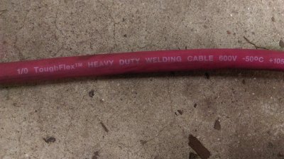

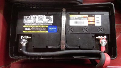

Add a second battery. You wont need any other heating devices to fire this beast up. :thumbsup:

Are you running the 6.0 starter? I'm running a brand new 6.0 starter on my 6BT swap with a single battery and it does the same thing yours does. I replaced all the cables with brand new cables and the battery is brand new. It helped, but it's still really, really lazy. The weird thing is the Dodge I took the engine out of I've owned for 13 years. It never did this when it was in the Dodge. It spun really fast and always started on the 2nd revolution. Every single time like clockwork. In all the time I owned it I never waited for the grid heater. I just hit the starter and it always lit.
I'm wonder if it has something to do with the 6.0 starter but I don't know anyone who's done the same thing.

interesting info. I'm running the 7.3 starter. I was actually able to get it to start first try at 19° the other morning, but it was really lazy, almost didnt.

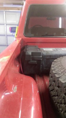

Now that I've added a 2nd battery, it probably wont get below 35° all season. LOL
