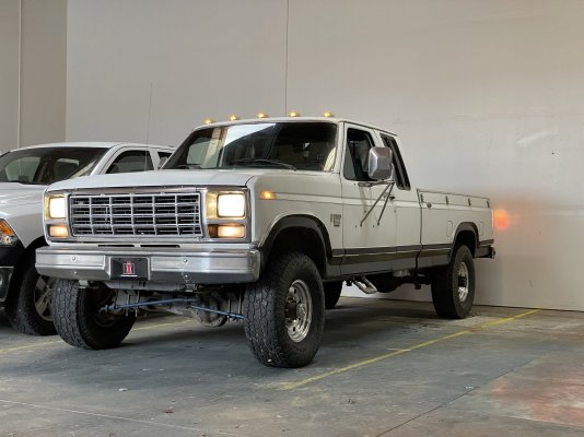

I’m running 295/75/16 (same width just a little taller) on the 16x7 wheels and I’ve never had an issue.
