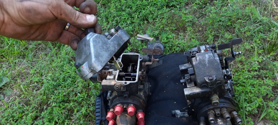

Like I just ran into with mine, had a strong audible click from the FSS but was getting no fuel delivered to the injectors (loosened the line nuts and no fuel was coming out). Great pressure to the pump, nothing out of the pump. I replaced this whole top cap from a parts pump and it fired right up. Maybe I should have just tapped the top housing with a hammer to free up the solenoid or something...

I had the same thing happen... fuel out of the filter housing,but not out of the IP. This was after sitting for a couple years. The FSS would click fine, but still no fuel.
I took the top cover off the IP and wiggled things around a bit. After that I replaced cover, cranked and observed fuel at the cracked injector nuts so I tightened them and it started up. Happened once more a day or two later... I repeated the "procedure", and really worked the little spring mechanism on the passenger side, which is bathed in diesel. After that it started up, and hasn't occurred again in a few weeks.
