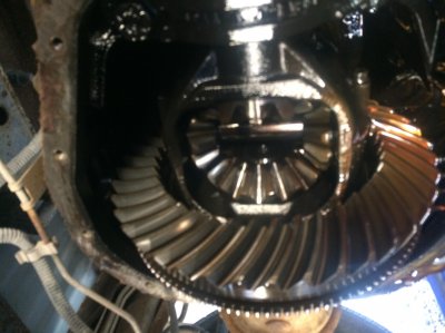

Without pulling hubs and inspecting further, I give it a clean bill of health.
Good fluid. No water.
The pinion seems like it was set a little far back,
But knowing ford it's still in spec.
No leakage @ pinion.
It is an open rearend

Looks like it meets my high standards. Maybe give the tires/hubs a good shake when its coming off for giggles and I think it looks great.
13,438
4,186
at 129k, i would be replacing them for S&G, if you plan on keeping it for a long time..
then you know you have new bearings, and youre good to go.
i will give you the brake lines, hyd& mechanical.
no shocks no sway bar, no rims... but a complete axle.
