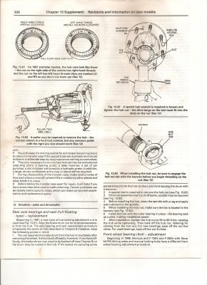

Left side hub nut is left hand thread. Oops, just saw you posted. Are DRW and single wheel axles the same length? May need to get a hub at the junkyard.
