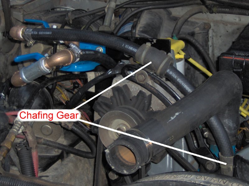

I noticed two points where the hose going to the water pump was making contact with the engine. So, following a habit I learned working on boats, I took a piece of rubber hose, cut it lengthwise, fitted it over the good hose in the location where it was contacting the engine, and zip-tied it in place. This is to keep the hose from chafing on the engine parts (the alternator above, and the alternator bracket below). I still need to keep an eye on the chafing gear; if it starts to wear through, the hose can still be eaten away. That said, it's far easier to replace the chafing gear than it is to replace the hose.
