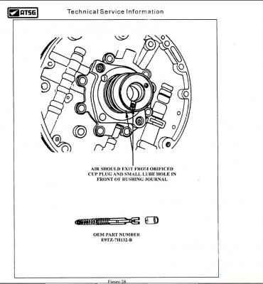

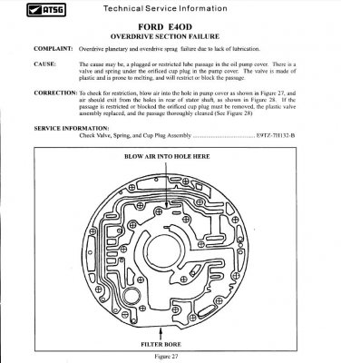

that plastic valve is what makes the converter lock up.if the bore is dirty due to neglected flushes,contaminates or if the trans has ran way to warm the plastic might have even melted.if that happens,no lockup even if the teca and solenoid say,yeah man we told it to lock up it just didn't listen to us.

here are pics of the atsg e40d/4r100 update pdf.
here you can see how i did great things with the superior k062 kit for log truck.this failed most likely and caused chip trucks trans to loose OD and thus thousands on a hd reman.
it didn't block off and cause a non lockup state in that truck though.i suspect it just partially blocked and caused the lube flow issue and thats why the trans guy found the mess he did behind my pump.man,you should have seen the clutches.he showed me.at 100k on the original trans.would have gone another 100-150k easy on those discs.they looked hardly wore at all.ah well.that's how she goes.they learned a lot about all the old flaws in the E40D over the years.
