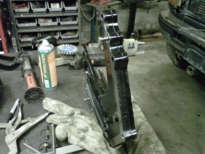

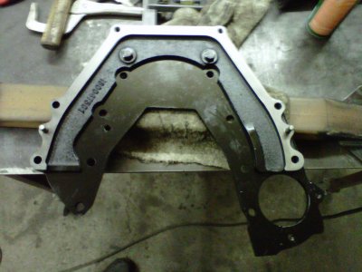

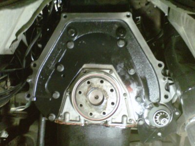

i like the Zf , i made my own adapter and i used a flywheel off a 2001 cummins with a southbend clutch for a 93 cummins to getrag splines are the same just had to make my own pilot bushing i have some pics of it all going together if you want ?

Heres a few of the adaptor. I seem to be missing a few other pic's. When i find them I'll post em up ;Sweet

To bad your in canada. Id be interested in buying an adapter. The 92 I bought was converted to 4x4 and someone put a t18 behind. Its pretty interesting to say the least. It has a ford dana 44hd with closed knuckles and kingpins lol.
