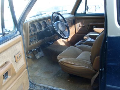

1,437
congrats.
I can't seem to hang onto the ones I bag. They sell for at least twice of what I get into them for and the buyers are from the midwest.cookoo
the appeal of a kali truck is the sheetmetal is not turned into hamburger meat from getting worked.
here's a couple of pics of one I hung onto for four hours.........

It is pretty clean! Both front fenders are buggered up but I got 2 nearly perfect fenders with the truck. I got the truck from a friend and he scrapped out another 93 a few months ago. With the truck he gave me another pump,turbo, intercooler and all piping and all small stuff that was easy to pull off. I just need to find a good grill and I will be able to paint it in the spring!
