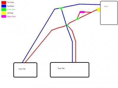

    I've been reading thread after thread on the subject but its still hard for me to picture the setup . I ripped a nipple off of my FSV and am trying to decide between the universal FSV and a manual valve conversion . I am also wanting to "Y" in an electric fuel pump that I can switch to for bleeding .. I know its not that difficult , but I can't seem to draw out a solution that works .. probably because of my lack of knowledge as to where the lines run to on the tank . Also , how would you be able to switch between sending units ?
    I know this has been discussed multiple times, so sorry for the repeat ..
    Does anyone have a diagram the possibly drew up during a similar conversion ??

    This is what I've been able to come up with ...
    Thoughts ?

    Lines routing looks correct, but I'd probably plumb the e-pump in parallel with the mechanical one, this way you ain't pushing fuel against its diaphragm. heck it may be a better idea to put the e-pump between the mechanical lift pump and the fuel filter, also place the junction that returns fuel from it into the main line right next to the 3-way valve - this way there will be no air trapped in the line between the valve and the junction, which is possible the way you have it drawn now...

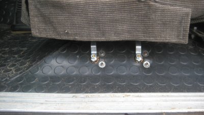

    My FSV suffered the same fate while I was laying under the truck trying to pull the lines off to bypass them because the FSV was pulling out of the front tank and over flowing the rear.

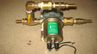

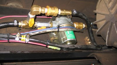

    I switched over to manual valves, and ran a Carter pump parallel to the stock lift pump. Midnight Rider is the one who first turned me on to this setup. I believe he just left all the wiring there, and uses the stock tank selector switch to change the gauge between reading the front or rear tank. Not exactly sure if it works that way once the FSV has been deleted. I cheated and use 2 separate aftermarket fuel gauges; one for each tank.

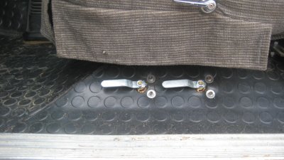

    I've got a couple pics of the fuel pump/check valve setup. Don't have any of the valves/plumbing, but I can get a couple if any one is interested. I mounted the fuel pump on the frame rail just behind the transfer case (you can see it in the right side of the 2nd pic). Mounted the valves through the floor just to the left of the driver's seat.

    The E pump would only be used for bleeding , so if it was ran parallel with the list pump wouldn't it have to suck through the E pump ?

    Not with the the 3-way valve before the pumps, it effectively closes off the pump you ain't using so fuel cannot flow through it and be sucked by the running pump.

    So .. same line route but instead of the E pump being on the diverted line it would be on the main line , and the diverted line would just be fuel line ? Just want to make sure I understand .

    Fuel lines come from the tanks and go directly to the 3 way tank selector valves. From the tank selector valves to the electric fuel pump setup seen in my first pic posted above. Return line just goes from the valve up to the engine.
    On the fuel pump setup, you can see a Y right before it goes to the electric pump; the line that doesn't go through the e-pump goes to the stock lift pump (includes shut-off valve just in case). The line from the e-pump is a second line run up to and T'd into the inlet at the fuel filter housing. So off of the fuel pump setup, there are 2 separate fuel lines running up to the filter head, 1 of them going through the stock lift pump on the way.
    The check valves are the 2 little canister looking things in the pic. They keep the fuel lines full up to the filter housing.
    1 other thing to add; my truck was originally a gasser, so ALL the fuel line in it is rubber (diesel rated, of course).
    Those who are really paying attention will notice that if my stock lift pump puked, I could just flip on the electric, but if the diaphragm ruptured, the fuel could still go through the T at the filter head and back feed down to the lift pump and continue filling the crank case with diesel. The check valve for the stock lift pump side of the system should be AFTER the lift pump, not before it as I have it. Gonna have to fix that here someday.

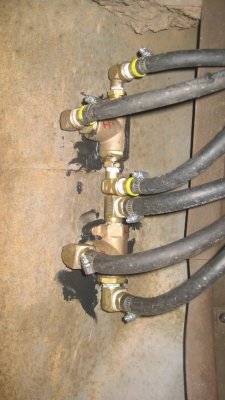

    Pics as promised;
    1st is the valves running off of the front tank
    2nd is of the valves running off of the rear tank
    3rd is the underside of the cab
    From the valves, the lines run over the top of the frame rail and are then tucked inside the frame rail back to the tanks.
