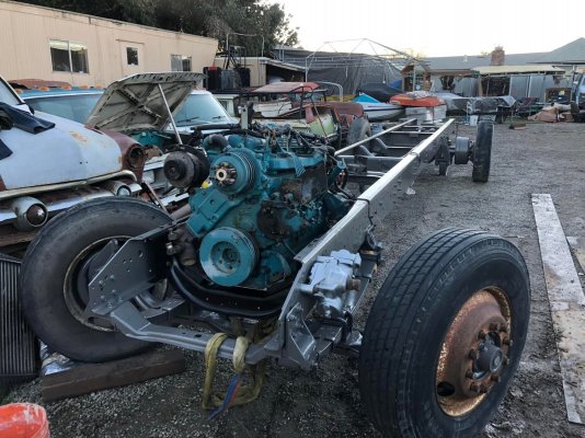

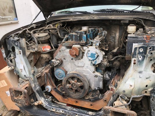

Isn't Brian @IDIoit putting a 466 into his 6 Door Superduty, or is that a 360?
its a 96 DT466.
got a 92 dt466 in my bus.
neither are done, and ive been slackin on my SD, but ill get it done eventually.

Thank’s Brian…. I thought it was.
At least the other projects you have been working on have been cool too…..
