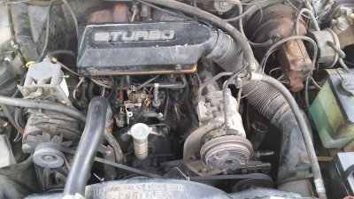

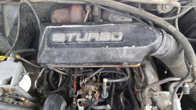

I'll be starting the build on my 86 soon and need to go ahead and get my RedHead Steering Gear Box ordered. I'd like to ask of any recommendations of reputable dealers known in the forums. I'd definitely like to give my business to someone who's known and deserves it. I'm new to the IDI world as I've just recently purchased my first diesel pickup. (86 F-250 XLT Lariat) SRW/Single Cab, 3/4 Ton. I will have pics uploaded of the truck and motor as - is within the next day or so.
Tranny needs to be rebuilt. Trucks runs and drives but you can tell it won't be long until she goes. I'm in the South Texas area.(Between Houston and San Antonio) lol "like that's not far" cookoo kinda close to Corpus Christi as well. Anyone know of any good tranny guys for my truck in these surrounding areas? Prefer to have a shift kit installed with rebuild. This truck will not be a daily driver so it can have plenty of down time throughout the build, which I'm sure it will :)
Thank you to all who can give any helpful tips and recommendations. New to the forum and glad to be here. ;Sweet
Also, I have a clip about one minute long of the engine running at idle but I'm not sure how to post a video on the forums. Searchin 

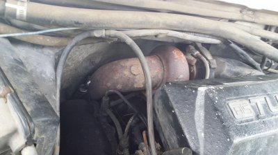

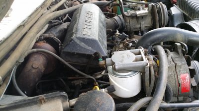

Thats an old school turbo. 085 ATS FYI. First ATS kit for a Ford IDI IIRC.
Google search R&D performance IDI, should come up with something. I would do all maintaince before looking into mods though.
Thanks for the info Justin. It's been gnawing away at me wondering exactly what ATS turbo is installed on the truck. Now I have a starting point ;Sweet
And about R&D, sorry I wasn't quite clear with my question. Who in the forums runs and operates R&D? I actually have the website saved into my favorites already. I've been drooling on my keyboard for the past 2 weeks as I sit and fantasize about having all of those mods sitting under my hood. :D
As for the maintenance before any upgrades, I highly agree with you on the matter. She definitely needs some TLC. Plan to have the truck running good enough that if I wanted to use it as a daily driver, I could without having to second guess it or worry about reliability. Any mechanical issues will be addressed before I start on the mods. All fluids and filters from front to back changed, brakes, tie rods and alignment. Compression test, vacuum test, etc.. Anything I can think of that needs to be checked over before I start to really throw some Ben Franks into the truck.

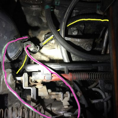

Glow Plug Wiring Problem

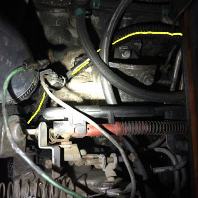

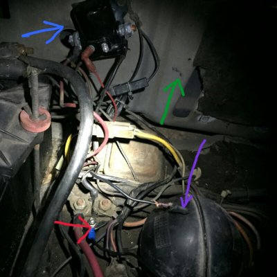

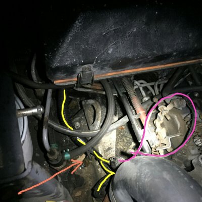

Trying to get some glow plugs working in the truck. Cooled off In South TX and truck is having some issues starting now. Swapped out all eight GPs with Motorcraft/Beru's I ordered from online. Truck had AUTOLITES in it so I felt blessed when the last one came out with no problems. No swelled tips. :hail
Post connector that the PURPLE arrow is pointing to in the pic is the factory purple wire that is supposed to be connected to the GPR. It was as is when I purchased the truck. Previous owner had a mounted manual push button in the cab at some point. Wires cut. A mess, I know. She's a work in progress :dunno
Can anyone tell me where the wire I highlighted in PINK is supposed to be connected to? Is it the Glow Plug Controller (GPC)? Wire highlighted in YELLOW is the glow plug harness. ORANGE arrow is spade connector/glowplug. I DO NOT want to use the GPC in my future set up at all. I want to keep manual push button for sure. I ran a new wire to a new (replaced) manual push button in the cab from the Glow Plug Relay (Red Arrow) where the factory purple wire would normally be connected. Second post on the push button I ran to a key on accessory in the fuse block with 20 amp inline fuse. Got nothing. Where did I go wrong? Please help, I'm lost on this one.
What number Fuse position on fuse block did you use for your manual push button if running one?
How do I know if my Glow Plug Relay is toast?
To Date - is there ANY aftermarket Glow Plug Wiring Harness available for a 86 6.9 IDI? I fear my harness may be the issues if all else fails. :(
One more thing.. I see these "Manual Glow Plug Conversion Kits" for sale when ive done my searching online. Includes the manual push button with what looks like some type of solenoid/relay I'm guessing and the necessary wires for hook up. Do these systems completely do away with the factory GPC AND the GP Relay?
I'm literally looking for the simplest system here. No Wait to Start light or anything. Just push, wait (4 secs max), let off, start.
Thanks guys!

Blue arrow is your Starter Relay. I could grab a pic in the morning of where everything goes.
TahoeTom
May 19, 2010
749
113
S. Lake Tahoe, CA
Jump a hot wire to the terminal your push button goes to (red). You should hear the relay click, and the large terminal with wires going to glow plugs should get 12v. I think the small black wire on that side goes to the wait to start lamp. The wire going to the terminal behind the radiator hose at thermostat (pink?) is the high idle/cold advance switch wire I think. There should be two wires on the top of the IP. The rear wire is from that switch. I'll look at mine and check back.
Edit: The pink wire may have gone to the in line fuel heater. The 6.9 had a heater element on the fuel line from the fuel pump to the filter head. I don't know if they ever worked or were necessary. If pink goes to heater, then the yellow wire is the one to the cold advance switch. The fuel heater wire has a plug connection and the cold advance wire has a two slot plug into the switch.
You are going to have to hold the push button 10 or more seconds to get enough heat to cold start. You may have to repeat a second time, at least I do.
