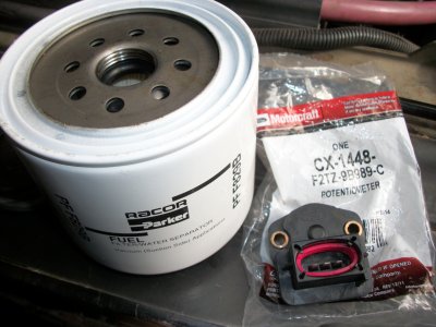

fresh fuel filter and it's time for a new TPS as well.hard to believe it's been 50k miles already;

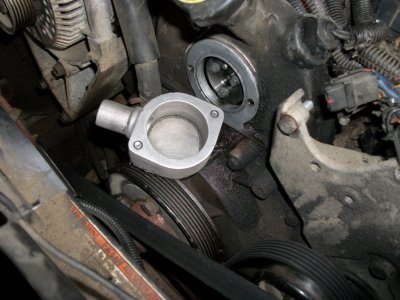

there she is.the moose is going in;
attachment.php

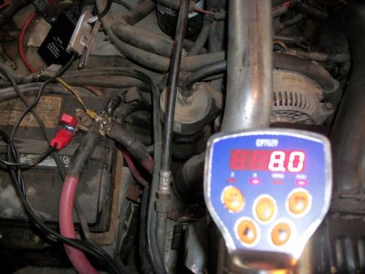

then i set the engines timing to 8.0 BTDC using the ferret/timing light w/ advance.

yesterday i just lined up the marks and primed the system.checking the timing i saw timing about 3.5 BTDC.
while checking the timing @ 2k rpm she expelled all air.

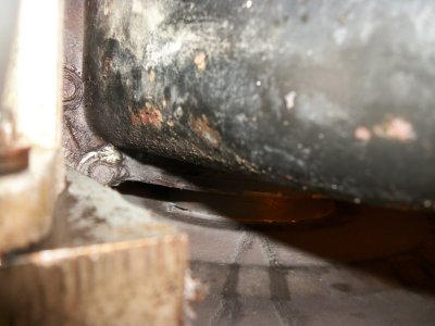

so i pull the inspection cover to take a peek.clearly i can see the crack in close by the crank:
attachment.php

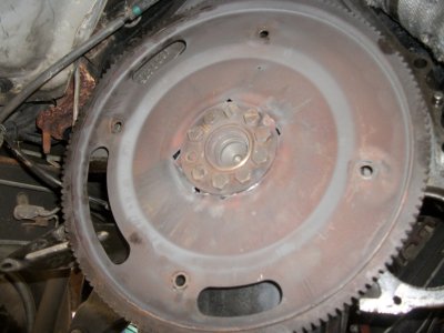

so i got the trans down and slid back and here is the issue in plain view:
attachment.php
remove the flexplate:
attachment.php
what are your guys thoughts on this? do i need to clean this up somehow?
attachment.php
attachment.php

It is hard to see from the pics how bad the crank flange is, but if it were mine, I'd probably take a file to it and take down the high spots.
Actually, I'm kind of surprised that no one makes a heavy duty flex plate for the IDI. You are not the first one to have this problem.

So that's what a broken flexplate looks like - YIKES! But your rear main seal is as dry and clean as can be - that is a positive! I am glad you were able to get the truck home considering how bad it was. I am with the others here - I would file/stone the hub down and get it as smooth/clean as possible and bolt it back together when the new plate comes in. Thanks for sharing the great pictures!
14,778
482
Jut looked pics over again.
LEFT or drivers side core/freeze plug does not appear to have a nipple dimple as such likely a reman. You should be qble to feel a slight nipple outwards dead centre in dimple for stock plugs...aftermarket that I hqve seen do not have said nipples.
Cannot see right side plug...
Just wanted to add tidbit...feel for nipples in the dimples a d report back.

i always figured this was a reman engine.while tearing into the e4od i could tell that was original due to the pre-95 high volume pump (and ware on it lol.)
you don't often see a pre-updated (to '95 spec or higher) e4od outlive an idi.you've got to think someone wasn't paying attention to something rather than a premature engine failure,though stranger things have happened i suppose.
yeah.iv never experienced this before myself.you think it looks bad,you should of heard it! lol holy crap.scary.extremely loud.
but how often do they fail though right? i mean the odds are the replacement will last another 20+ years.i know though,iv seen these pics before from time to time of others with idi engines.a heavier duty version probably wouldn't of been a bad idea.
funny how it failed.with all the heavy loads iv hauled with this thing,the thing fails running empty under light load at about 50-55mph.

Makes you wonder about some harmonic issue of some sort? Just a WAG but something to think about.....

Interesting thanks for showing. What do you think did that? Stinks a $65.00 part causes that much work.

i dunno.i just figure age makes them fatigued after a while.perhaps the high torque starters just wares 'em out after awhile?
