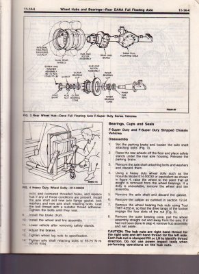

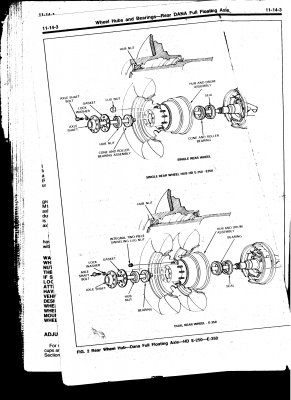

Pretty sure the studs are not LH. They could be 9/16 or 5/8. You probably have the Dana full floating rear axle, that's what my Class C MH has on the F350 chassis. I don't think I would try to fix it in a parking lot. To transport a mini bus is going to be $$$$$$$$$$, check it out.
Here is some pics of the axle and what your up against from an 89 manual.
