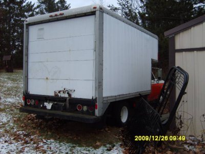

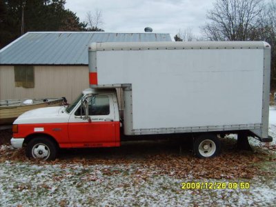

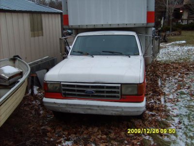

Going to look at an early 90's IDI Uhaul truck soon. Pickup truck based unit, so its a cab and chassis truck. Still has the box on the back, IDI Auto. I am guessing on the year, might be a brick nose. less than 65,000 miles. Running driving unit. Was used by a grocery store for pick ups and deliveries after its time with Uhaul. Current owner bought it at an Auction on a whim and was the only bidder. They used it for a year renovating their bar, and now want to move it.

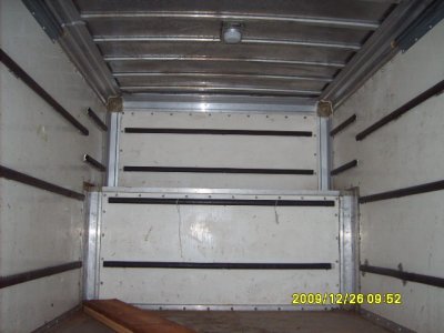

I have no use for the box, whats its value? I can buy the whole truck for $1000, and I am told the truck body parts are solid minimal to zero rust.
Its a DRW truck, tires are good.
I have only seen it from the back side months ago...

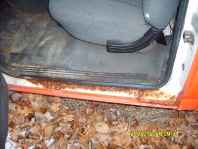

Looks like there is some rust under the hood and in the door jamb.
Truck has sat most of the summer, they went out this week, let the glow plug warm and it fired right up.

a grand for a low rust running truck in your neck of the woods is a steal., especially a nice heavy duty job like that .So long as it's not hammered
itsacrazyasian
residentcrazyasian
Nov 4, 2010
2,128
boca raton, fl
the nice thing about uhaul trucks is they knew about the cavitation problems. They used pink coolant when they were in service with uhaul that was sca precharged. All the F series trucks with IDI's were bricknose. The later IDI's were in the E series chassis. The later OBS F-series were 460 BBF.
1000 is a killer deal. I bought a uhaul truck from its 2nd owner to transplant into my 91 crew dually years ago. I had all maintenance records with the truck. Depending on how long ago it went out of service, uhaul might still have service records for the truck.
They were all C6 transmissions. The engine itself, they had an extra oil tank for extra capacity and heavy duty tranny cooler for the c6.

Here is what my Dad was able to fin out about it.
Speedo reads 61218, probably + 100K, who knows, trans is "G", (auto),axle is
"65", 16 X 6 rims, body is "CJ8", 11,000 GVW. Only "Outside" rust is on front of
hood, inner rust on rockers . Other than that, the body looks very good, box is
in good shape, Randy Matzke painted the sides to cover up the store name. Store
in Oxford had it after it was a U Haul. He said he went out a week or so ago,
AND IT STARTED GOOD, glow plugs must be good shape. Both batteries were new in
July 2009. Interior is very good, just needs cleaning. FACTORY A/C. Tires have
some good tread left, maybe 50/65 per cent.

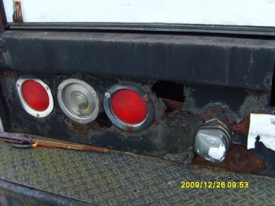

Well, I picked the bad boy up, its a bit rustier under neath than I thought. Its still a solid ride though.
Thinking of selling the box come summer, and putting a low boy type ramp back for car hauling. Anyone ever build one? I think its too good a unit to part out.
This thing cannot have alot of top speed, even if it didnt have the box. 4.10 gears and 215/85r16 tires on the back........
