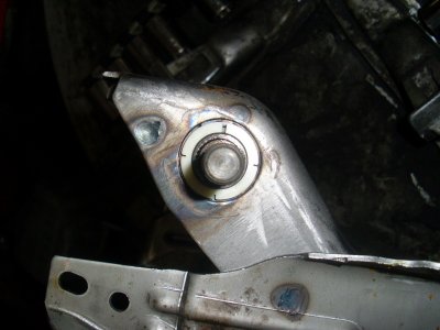

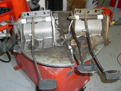

why OBS clutch pedal brackets suck.

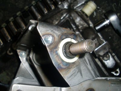

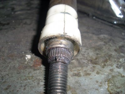

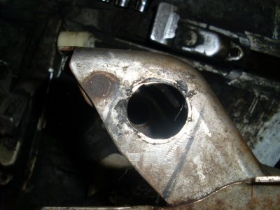

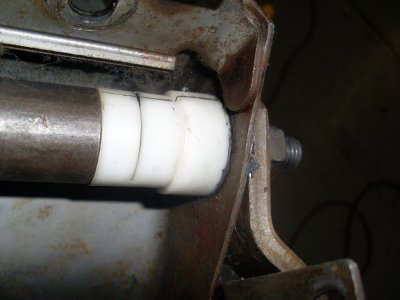

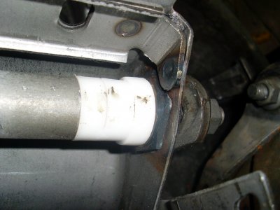

two steps forward, one step back. the 80-91 pedal brackets led to the problems of firewall cracking. the 92-97 bracket did away with the problem but developed a new one instead. the older brackets has a large bearing surface for the shaft to ride against, the new style has a bearing surface that is the width of a drilled piece of sheetmetal.:eek:cookoo no ********. see the pics. the updated bracket did have a chickenshit solution, they added a nut that increased the surface to 1/8" for the plastic bushing to ride on.
lookie at the pics.

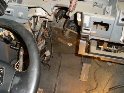

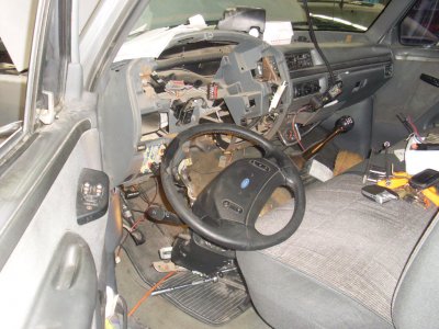

How hard is it to change out that pedal assembly as in , how much time spent contorting oneself under the dash, because I don't bend very well any more.
My 92 has started a bit where both pedals start wobling a tad when I go for the clutch and brake at the same time. I think it's fair to assume that the goodies towcat pictured are the culprits .

It's kind of a paint for sure to put them in and out. Towcat, thanks...so the original post was just stating the purpose in design differences between the Gen 8 and 9 trucks?
that is the exact culprit for wobbling OBS pedals.
it's not a fun job to do but not the end of the world either. it took me a little longer due to communications equipment and lighting relays crammed under the dash.
lookie at the pics.
This is what had me confangled....it really is no use for me to try and comprehend with a migraine. :rolleyes:
the older style brackets had 1.5" to 2" of bearing surface for the clutch to ride on. that was fine. the material they used to make the bracket sucked. when the redesign happened with the OBS bracket, they went to a "stiffer material but killed the bearing surface. I didn't say anything about compatibility between the two generations, just a comparison between prro design and bad material choices
