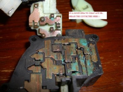

well this happened to me last year with my 94. if you have the delay and switch built into your turn signal switch it should be the same as mine. it ended up being the switch itself on the column. after replacing it i **** the old one apart "just to see":D . turns out where they crimped a wire to a connector the ground wire broke off and was only making intermittant connection like you described. this wire has to flex everyt ime you turn on your signals and just broke from fatuge and could be soldered.
i still have the switch and can try to get some pics tonight to explane what went on mine. thought about doing some kind of write up but never got to it. of course it could also be the above suggestions.

sorry i forgot to get those pics but my box was clicking as well. its located to the passenger side of the glove box. i even pulled tore it apart and couldent find anything wrong off hand.
i would still suspect the wires inside the column switch.

this isent an official write up at all but should show you what i am talking about. sorry my switch is a little dirty and i think i lost some of the screw because it was just sitting around in my garage.
mine acted the same way that you described, even if this isent your problem maybe it can help someone else.;Really
