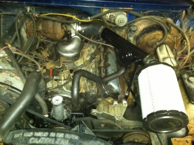

Dsl_Dog_Treat
I lost my face to the jaws of a poodle
Jan 13, 2005
7,191
161
Decatur,MI
nice i like it, i wonder if it would be worth the upgrade to do something similar on a factory ATS setup.
Sumpthin like this?:sly
Disregard the current CDR tubing. Was temporary until I got a straight line piece of tubing to route back into the adapter.;Sweet
ATS 085 system.
Uses a 2.5" to 3" radiator hose adapter off the turbo to 3" exhaust pipe where I drilled holes for CDR opening. I welded nuts onto the tubing for the CDR to mount to then made a bracket to stabilize the tubing. To get to the air filter I modified a PSD intake elbow to adapt the filter and angle to the 3" pipe and that was it.
Now my winter beatin work truck is turning into a hot rod. :D
