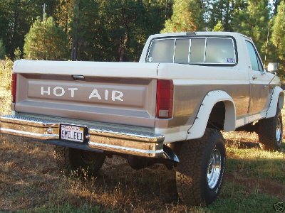

NOt sure whos truck this is but i believe it was on ebay at one time, anyway dave s. over on fte saved the pictures

681
That truck had a BDS blower on it and the truck was in the Fresno Ca area. I live about 4 miles from BDS so I took the pictures of that motor to them. They told me they didn't have anything to do with the buildup. I asked about the intake manifold. They could build me one but... A one off was going to cost between $18,000.00 to $20,000.00....:eek: The price would come down if they got more orders but geez... I found out that setup didn't do anything more than what a turbo does for our motors. Please remember the hp loss because the blower needs power to drive it is around 10%. So if you have a top fuel motor making 8000 hp you loose 800 hp right off the top... Thats about the hp of 9 non turbo idi motors.....:rotflmao:sly Yes... The blower drive setup looks great but will it push the truck down the road any better... I'm not thinking it will... Sorry to burst someones bubble....

Woah. Didn't expect that! A 6-71 on an IDI; now that's something else. Man, thanx for the pics.

Dyoung14 get's the award for "Oddest Forced Induction Find For an IDI";Sweet
Ya did good:thumbsup:

here's one of the pics, more later when I get home
