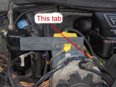

What does your alternator look like?
I'm attaching a picture of what my alternator looks like. Note the tab that's pointed out (where the top bolt goes through). This tab is there specifically so you can put a wrench (I usually use a large crescent wrench) on it to pry on the alternator to get the alternator belt tight. Maybe not all alternators are set up like this?
Also, you probably already know this, but you can tighten the vacuum pump belt independently of the alternator belt. IIRC, there are three bolts to loosen on the vacuum pump mounting assembly (no pictures, sorry :( ), and once those are loosened, there's a hole in the mounting bracket to put a 3/8" drive ratchet or breaker bar on to pull the vacuum pump tight.
Hope this helps...good luck!

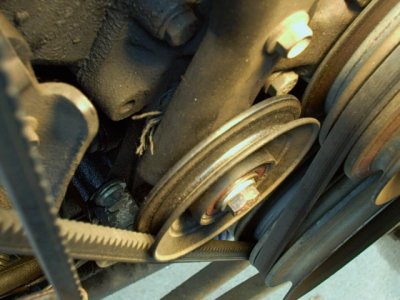

You could get a 4"OD pulley at autoparts store and a bolt long enough to go thru pulley and a few washers to line it up with the other pulleys. It doesn't remove all the flopping but it does take out enough that the belt doesn't hit anything. OkieGringo
4" outer dia. on the edge of the pulley or where the belt would run inside the groove?

Thanks, everyone. I got things tightened up just perfectly, thanks to y'alls advice. :) Couldn't find a wrench big enough to get on the tab of the alternator, so pulled like crazy and tightened at the same time with help from a very long socket on my socket wrench. Belt is as tight as I've ever felt it... Tidied up the alt-vac belt as well...

Jim73 said:
Okie, did you have a NAPA or other chain's P/N for the pulley you used?
Jim
Well, I got mine when I lived in Baja. I went to parts store told him what I wanted and he went back to the shelves and came back with one. Worked perfect. But, dlblack over on TDS saw my post about the mod and went to Autozone and got one, part # 45954 and a 3/8"-16 x 1-1/2" hex flanged cap screw and some washers to line it up. He has photos in his gallery "over there". Hasta Luego, OkieGringo
Hey Okie, Thanx a million for this idea. I just put one on my 91 and it works
F A N T A S T I C, I mean when you put on a GATES belt and this pulley and then get it just tight enough, NO BELT POPPING left. Anyone that has not done this, REALLY NEEDS TO.
One question, I used the bolt size you had stated, but I would really like to get the bolt that really goes through this pulley. It has to be designed for some type of engine. It should have a fatter shank before the threads, that way it would fit snugger and be even farther from the water pump pulley.

I found some airconditioner idler mounting bolts on older ford cars have the perfect shank, also maybe a good hardware store would have shoulder bolts, they usually have an allen head tho. I may have my bolt guy get us a box and ship them around, I will get on that.
