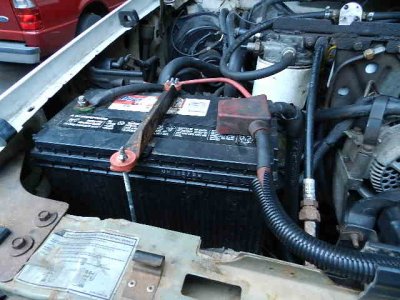

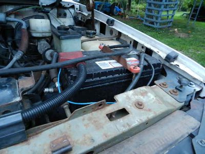

it is tight fitting group 31's in that year truck, there is more room in older models. i could not fit the regular post top terminals so i upgraded to the stud tops. you can see in my pics that i used welder cable ends and heat shrunk all around them. i also spread some grease around everything to keep moisture out of the connections and rotting them out.
the stud tops fit fine for me, i held them down by cutting a piece of angle iron to fit over the top and keep them clamped down. i also shimmed up the side of the battery with a small piece of wood so it was not riding on the battery tray edge.

Jred, those batteries are shorter than any I've seen. Did you shorten the studs? They look shorter than the one stud type I have.
On Edit: I mean that they look shorter anyway.
Batteries are supposed to be replaced in pairs as posted above... Heres why. Think of a new battery as a full tank of water. Now connect the new battery that used and lower on amps because its older. Run a line to both of them. The full tank or battery will drain down to the level of the low tank or battery. They will finally even out but they both are low now. I know its kinda expensive but its the right thing to do. I think if you cut the battery bottom lip on the holder the battery may sit lower. You can cover the terminals with a thick piece of rubber too. that will protect the + side from grounding out on the hood.
