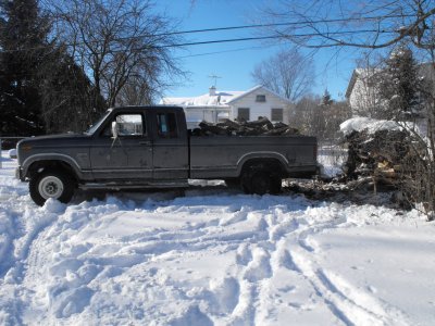

http://www.youtube.com/watch?v=r6pRBdNImkM The key cylinder sticks when it's nice and cold,that's why I keep messing with it, and the heater won't come on unless the key is in "that" spot. Pic of some firewood too
