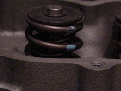

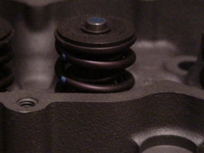

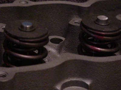

The dual spring kit for the powerstrokes from hypermax works as well. let me get a pic

well here we go no pics sorry didnt have camera
but it fits same height same dia inner and outter
but one biggie is its much befier i dont think well have a problem cause its soft till it goes 1/8th inch in
but if yall wait ill run them for a bit and see idk if i should run them in my truck (dd only vehicle now) or the jeep (going to be rarely used project)
the truck will see better real tests like towing etc.
