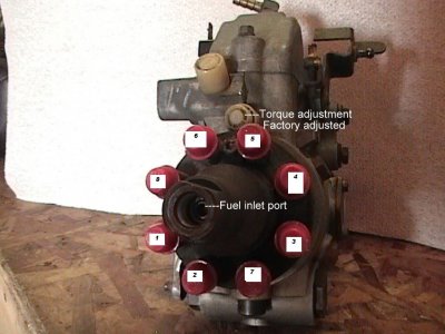

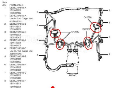

338
If by chance you remove the lines from the IP, be sure and mark them to which injector they go to. Here is how they go back on the IP. 2-7-3-1-4-8-6-5. Be sure and replace the clamps if you removed the lines. You can see pretty much how the lines are inter tangled from the clamp pic.
