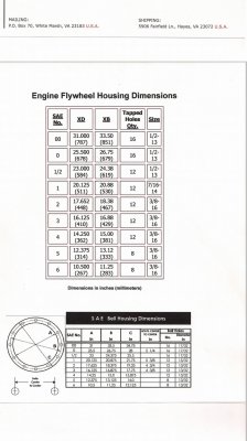

This is an sae bellhouseing chart
Sent from my SAMSUNG-SM-G870A using Tapatalk

Sounds like you two know what fits what. I would like to put an IDI or DT460 in my winch truck.
Currently has a 396 tall-deck and a Spicer 5-speed. What bell/adaptor would I need to mate to
the transmission?
Measure the bell your Spicer has now, refer to the chart posted by RustyGold. Then try locating a bell of that type for your desired engine. Or, if you find a medium-duty donor truck, good chance that will have both the engine and the proper bell for you. Especially if it's got a big 5-speed behind it, which is how most of the older ones came (they often use a 2-speed rear axle to split the widely spaced gears in the 5-speed trans, as opposed to a fixed-gear axle and a transmission with a built-in range and/or splitter like how larger trucks are done).

Already had a SAE chart. Are you saying the International pattern is SAE?
And that mine has an adaptor on it now?
And it does have a 2-speed rear... Just didn't think it was relevant.
My Mack has a #3, I think. Looks very much larger than the Ford.

International pattern is its own thing actually. Just like how Cummins has their own pattern (the 8-bolt tall and narrow trapezoid for the 6B series for example). The 396 you have now is probably its own thing as well. Basically most engines have their own specific bolt patterns, and their manufacturers also produce (or have someone else do so for them) adapter plates/housings to take the oddball engine-specific pattern to a standard SAE pattern (or any other pattern required, as is the case with both the IDI Ford and the Cummins Dodge). And sometimes the same engine has multiple sizes of SAE adapter plates/housings available for it, you puck the one you need based on the trans you have. If the Spicer is bolted to the 396 via circular bell, that's a SAE adapter housing hanging off the back of the 396. The Spice ESO (Easy Shift Overdrive) 66-7B (7-speed) for example appears to only be available for SAE 2 bells, so whatever engine you find one behind will have kinda adapter on the back of its engine.
Depending on what your Mack is, it could very well have a SAE 1 housing.
The reason I mentioned the 2-speed rears is to explain why there are not that many 10-speeds instead in medium-duty applications, aka why finding a small 10-speed (especially an OD unit) may prove to be somewhat difficult depending on location...
