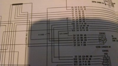

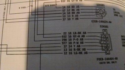

I bought a manual on a disc, searched it and googled for about an hour now. I cannot find the wiring diagram for my 91. I'm looking for the diagram that shows the engine sensors (temp, oil, high idle, and fuel solenoid), headlight diagram (trying to figure out that silly DRL plug and how I can eliminate it) and hvac motor and ac compressor. I'm trimming down the harness so it'll run to the engine and not take a lap around the entire bay to clean up the DT swap. Thanks!

NOt sure if this is what you are looking for but here is what I have in a quick look through my books.

3kp that looks like it, any way you can scan them in? Thanks!
