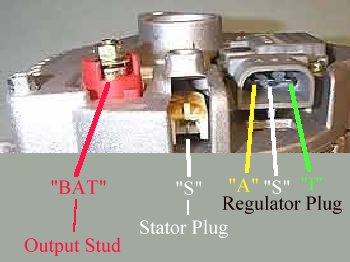

How I did 3g basically after putting the alternator in place the yellow wire goes to the back of the alternator where the power wire goes I ran for the power wire from a Crown Victoria to the fender selenoid small white wire goes to its own separate small plug and the green with red tracer gets spliced together with the old existing green wire with red tracer and gets plugged back in to the clip closed by the passenger inner fender

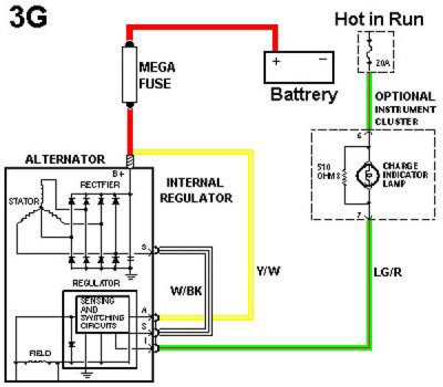

thank you! Basically looking at this what I did it could be wrong is the yellow wire labeled a I ran that back and put it on the output of the alternator just not sure in the picture of the diagram you sent me the yellow line that runs to the bottom of the fender selenoid?

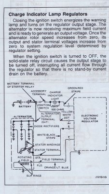

338
I guess I should have asked if your using an external regulator or if the 3G has the internal regulator. The pics I got off the web 1st and second show an external regulator.
!st pic here is with the internal regulator.
2nd pic is with the external regulator.
