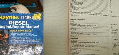

I think I may have slipped a cog in my brain... I was checking cylinder bores with a snap gauge a few minutes ago and grabbed the Haynes manual to see if they were still in the ballpark. I noted that bore and stroke are square (4.11" x 4.11"). I decided to see for myself whether our 7.3L engines are closer to 444 cu.in. or 445 cu.in., so I did the math... Pi x Radius squared, gives area.. So, half of 4.11" is 2.055". Now square that- (2.055" x 2.055") = 4.223025", right? Pi is 3.14159, and the bore's radius squared is 4.223025, right? So then, 3.14159 x 4.223025" = 13.267" area, right so far? The stroke is 4.11", so 4.11" x 13.267" = 54.527 cu. in. per cylinder, right? We have 8 of those, so 54.527 x 8 = 436.216... Every time. I know I have to be doing something wrong, but the calculation is a simple one and it's defying me. Anybody see anything obvious where I'm screwing up??:eek:

Your math is correct and I don't feel someone was teasing you about doing the math in metric. The problem is the stroke figure is wrong. So is the Haynes manual you got it from. Sad to say the Haynes manual is not the best example of what these idi engines are. BTW I have the same Haynes manual and have for many years had 2 of the International CGES435-1 engine service manual. Its a far better shop manual telling everything you need to know about these engines. It covers connecting rod twist to piston fit to so much other great info. The 7.3 bore is 4.11 and the stroke is 4.18.
Yes sir, I see that now.. Gotta admit that I'm pretty disappointed with Haynes. It makes me wonder what else may be in error. You wouldn't be interested in selling the more dog eared & dirty of those CGES435-1's, would you?? :D
