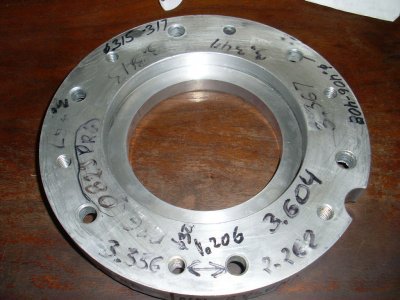

1,437
this adapter ring is also what needs to go with the USG Tim posted.

Good point Calvin, I always forget about the clocking ring. They bolt pattern is the same as a t-case, but rotated for some reason.
